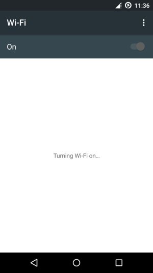

Nexus 5 Wifi Won't turn on. Help Please!
A few weeks after installing the Android 5.1.1 Lollipop update, I began having issues with my Nexus 5. When I go to turn on the Wifi in the settings menu, the toggle switch is grayed-out and I can't use it. Instead of the phone finding connections, I just get the constant dialogue that says "turning wifi on." This just stays like that and I can't use any wifi functionality. I've tried fixes like installing custom ROMS (I tried Paranoid Android and CyanogenMod). I tried rebooting and factory resetting. I even called Google's customer service line and they were unable to fix the issue. Please Help!!

Nothing helped. A complete reset and I'm still seeing "Turning Wi-Fi on..." endlessly.

Thanks but I did a factory data reset--only the most basic google programs remain--nope. After that I did a safe boot and still no luck. Fiddled with band setting but because the wifi never fires up it reverts back to automatic.
My theory is it overheated while charging or gps-ing and the connection to the wifi antenna was broken. See arianboy1's post above yours where he had the wifi connector re-soldered. Of course mine is out of warranty.
