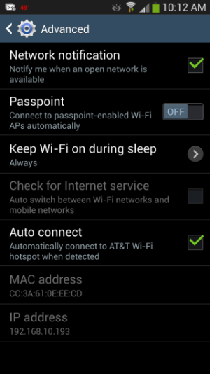

The option 'Keep Wi-Fi on during sleep' is already set to Always. See attached pic for other options, which are still at their default. My router doesn't offer 802.11ac or 5GHz, so there's nothing to change there.
Roger
