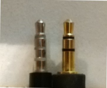

Sure sounds like the fit is not very good. Perhaps the headphone jack is a little too small or too short for the Nexus 7's socket. Have you closely compared the jacks on your devices?
Both jacks seem identical - only difference being phone one has microphone, but that shouldn't rly matter.
The one on the right looks a little bigger to me. Also, it seems like if you align the shoulders (bottom metal ring) there is a little difference in where the segments align.
might be due to colour difference and crappy quality of the photo, they are exactly the same size wise, only difference which i noticed now is that the yellow jack (one that causes problems) is a bit crooked :o
Have you also checked to see if there is any debris in the headphone jack? Use a damp toothpick to root around, or use a bottle of compressed air to blow it out.
Being crocked (or bent) could be the source of your problems. I have messed up several headsets by rolling over the ends with my office chair.
