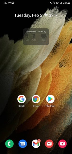

I meant seeing the 5GE icon along with the Wifi connection icon at the same time on my S10. I'm seeing that on my new S21 along with the 5G icon.
I think you mean seeing the 4G icon and wifi logo at the same time on your S10. Your S10 does not have 5G, thus you would never have seen 5G and wifi both on your S10.

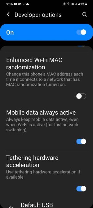

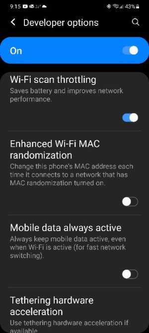

I did find a switch that will toggle this. Have you changed anything in developer options? If you go to settings>developer options, look for a toggle for mobile data always active...if I toggle it while connected to wifi my 5G indicator goes on and off...just wondering if you may have turned on by accident..

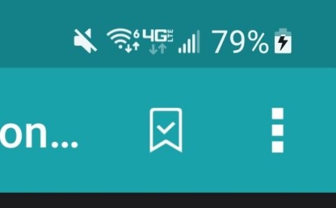

I'm on a Note 10+, with no 5G, but I see 4G while WiFi on all the time. Never cared or even gave it a second thought.Screenshot_20210801-050459.jpg
