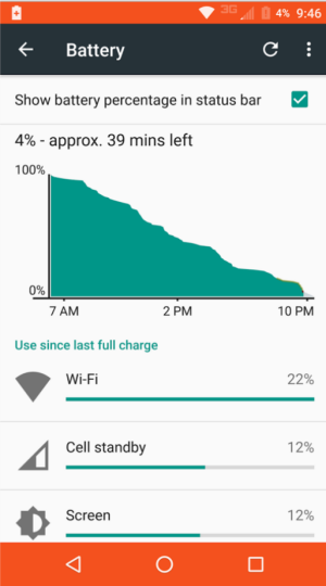

For some reason my wifi is killing my battery
After a full day of use 20% of the battery is killed by the wifi?
Does anyone have any advice or ideas?

Dang, my WiFi is ridiculous too!! Just looked at my battery stats as I'm all of a sudden at 19%. My WiFi consumption is 18% usage and I have been at work all day not on WiFi. I mean, I always leave it on, but have never noticed that drainage until your post! What gives!?

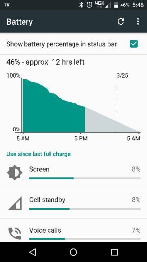

Alright, here's the deal with today. I disabled the Bluetooth and WiFi always scanning setting along with a cache wipe this morning. One difference I noticed is that my GPS kept asking me to enable WiFi always scanning. I understand that I turned it off in settings of location, but why would it need that? Stupid question, does WiFi use GPS at your house, McDonald's, etc?
No WiFi stats today.

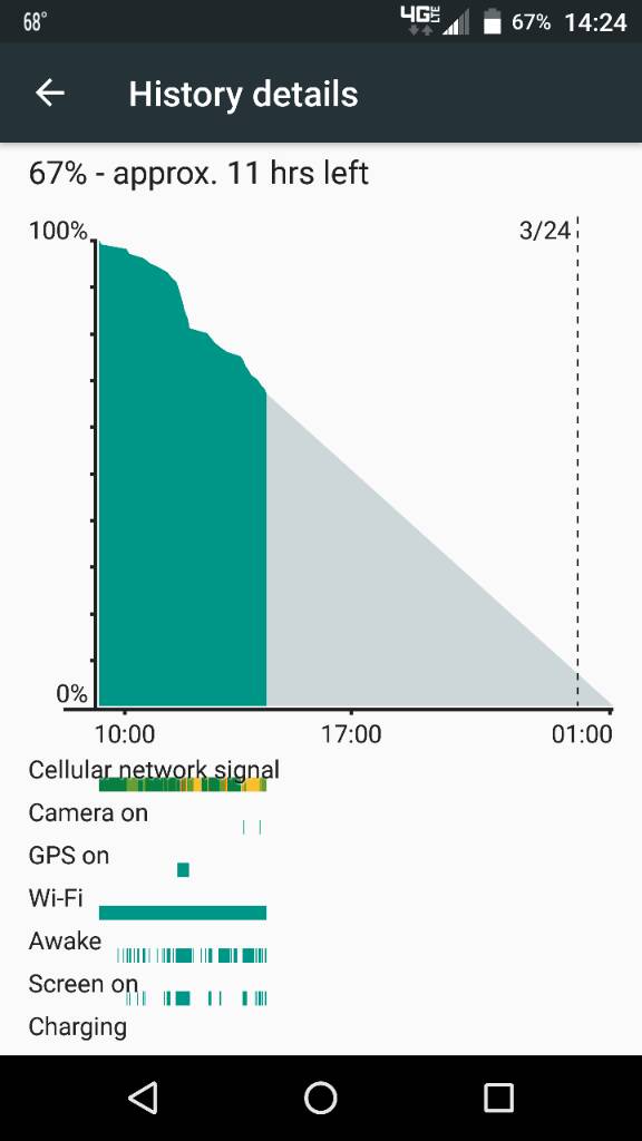

I just turned my phone off then back on a bit later & no WiFi is showing in the battery stats screen. If it does come back then I'll turn off the always scanning thing.
Gonna turn WiFi always scanning off now as my WiFi has appeared in the battery stats screen again.
