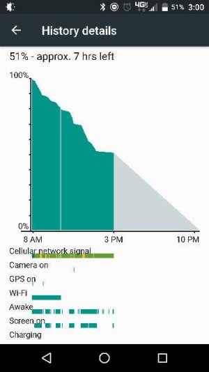

And for proof... the vertical white line busting up the downhill green mountain (as I call it, sounds better than battery drain) is where I uninstalled the app and did a cache wipe and you can see after that, no WiFi solid green.
Some of the downhill slope is legit usage but it leveled off even when not in use, whereas earlier when not in use it kept going down.

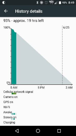

But, with no WiFi on/off app installed, and WiFi turned off in every conceivable way in settings except having it on overnight from the pulldown menu on the home screen... When I woke up I turned WiFi off, drove 30 minutes to work, and waited another solid 30+ minutes, and the solid green bar of yesterday is gone and I have a projected 19 hours unless work is boring and I go crazy surfing.
So I am convinced *my* issue was the app I had. Now, do I try another app and see what happens? I probably will. I am always up for experimenting.
But basically, if WiFi is on, the battery will drain badly. If an OS would have auto on/off built in, that would be sweet. Until then, I will have to remember to turn it on/off manually.
Not sure how much this helps anyone, but maybe it is a start.
