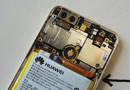

Judging from your description it sounds like the internal antenna the problem. It's basically just a wire that extends along one side of your phone so maybe it became disconnected from the motherboard, which account for why you can get a WiFi connection holding your phone close to your router but not when you're farther away.Honor8_antenna.jpg
The pic is taken from this Honor 8 teardown site:
Huawei Honor 8 Teardown | MyFixGuide.com
Not very familiar with Huawei phones but most Samsung phones just have a press-fit connector for the antennas. Looking at the above pic it 'appears' that maybe it instead is using a solder joint.
