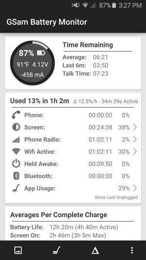

Hello, i am trying to increase my battery life because it snot all that great right now. I'm only getting about 3 hours of screen on time. I was thinking about doing a factory reset, but wanted to try to fix it before i go through that. Looking at my GSAM battery stats, my WIFI Active is just as high as my screen usage. Both are at over 30%. Having Wifi use that much of my battery doesn't seem right to me. Also Its a sprint GS6, any Ideas?

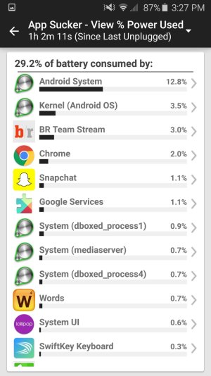

I don't think WiFi is the actual problem. Can you post a screen shot of the battery usage screen along with the page that gives you more detailed information about the highest app/service?
Hopefully we can find the problem (if there really is a problem) and save you from a reset.

i just happened to charge it.

There is currently a bug with GSAM that mis-represents the actual percentage of battery used by WiFi.
In order to rectify this.
- Open GSAM
- Go into Preferences
- Scroll down to Device Power Profiles
- Enable Custom Profile
- Edit Profile
- Change the value for WiFi Active to 767.
- Save and you're done.
GSAM will now correctly display the battery percentage associated with WiFi Usage.
