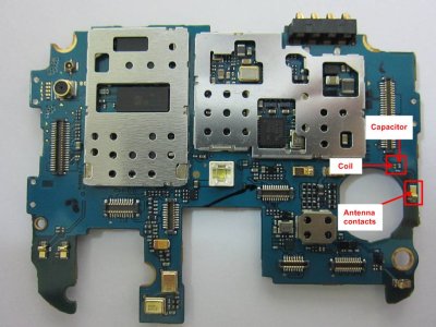

Thank you for the reply. I will try this out ASAP and let you konw how it goes. Just one quick question.
Did you remove the whole back cover as shown in the pictures below? Or were you able to just pop off the little plastic antenna cover which is shown in picture 1?
I ONLY took off the battery cover. I just rubbed the little plastic antenna area that is in the box in the first pic. Just to stress, I did not remove anything other that the battery cover.
Sounds a little bit like magic. The truth might be that your antenna connector has loose contact. The antenna connector (pic 2) is a spring contact, which in my case was pressed down and had no contact. You have to remove the "midframe" (google for an unmounting guide)! Then slightly pull up the spring contact for the wifi antenna until it looks like the other spring contacts.

moi aussi jai rencontrer meme probleme que siegnal wifi faible alors jai dessoude le COIL et jai changer la petite capacitore et le problème a été résolut waaaaaaw :):):):):):):):):)
