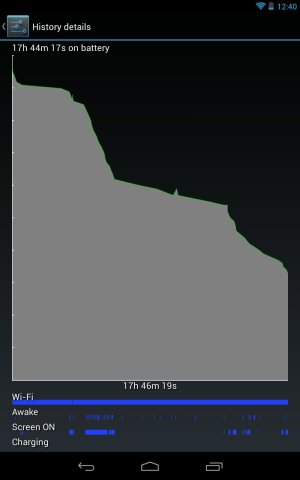

My battery life is also very poor after getting the Android 4.2 update. WiFi stays on through the night even though I've changed the settings to turn off during sleep. Though as the attachment shows.... Nothing. It always stays on.
Turning off Google's Location Services works. It is unfortunate that I won't have Google Now.
