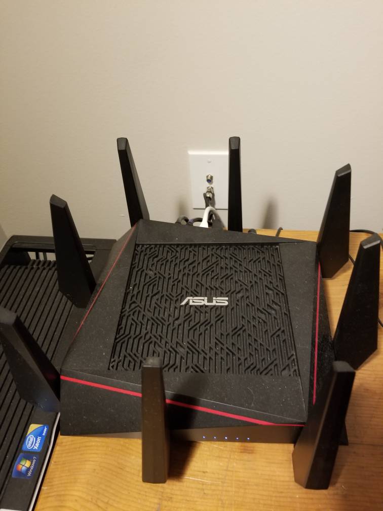

My Asus ROG Rapture GT-AC5300 pulls 900 or so down with no issues.
