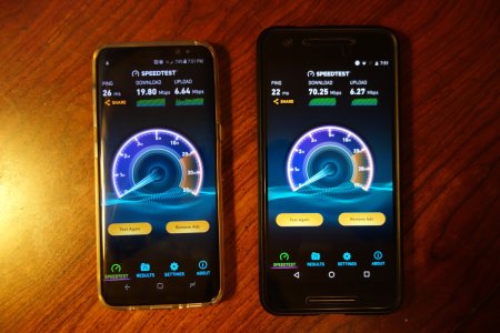

I have my Galaxy S8 on hand since the 19th of April, and so far have had a total of 2 issues, one of which being the red tint issue.
There's this other issue that I just stumbled across, and it's bothering the hell out of me. Sometimes I'd notice that the wifi symbol on the status bar would show an exclamation mark and the wifi would suddenly stop working. All I would do is move my phone a couple inches away and it'll start working again. I can't even watch a YouTube video without suddenly "losing" connection and having to move my phone a bit to resume video playback.
I thought this was weird because my past phones has never had a wifi range issue. I decided to further diagnose the issue.
Not only am I not getting a decent connection to the wifi network, the speeds I'm getting off my wifi network are horrendous! I took a comparison against my old phone, the Nexus 6P, and tried MULTIPLE speedtests (on the same server), all with the same kind of results. Extremely slow speeds on the S8 and faster on the 6P. (See Image Below)
So I'm wondering, am I the only one that has this issue, or are there others out there who are experiencing this as well?
Like seriously, what kind of madness is this? HUGE difference..
(I know 19mbps isn't the slowest but I was actually lucky to achieve that speed, usually it's lower than 10mbps.)
Also, if you look closely at the picture, you can see the wifi symbol in the status bar has the exclamation mark!

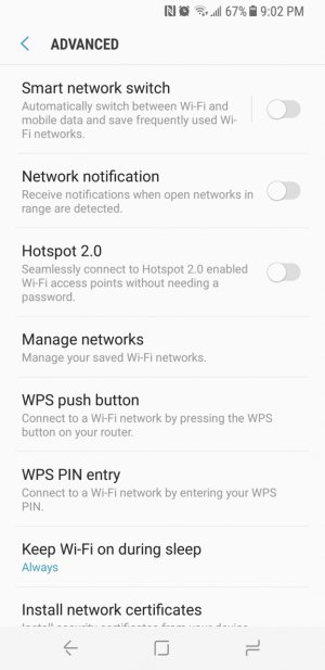

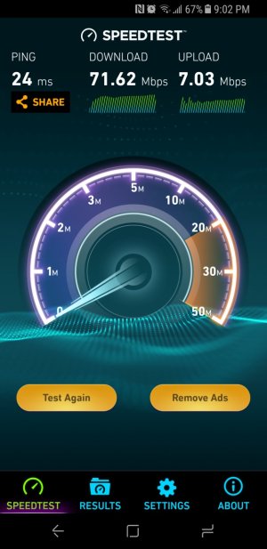

Both 2.4GHz and 5GHz gave me the issue. BUT.. I figured it out. On the phone's end, make sure Connections > Wi-Fi > ADVANCED > Hotspot 2.0 is ticked to OFF. It was ticked ON for me, and as soon as I ticked it off, I got 71Mbps down. Luckily it was just a stupid toggle and not some major issue.
View attachment 258371View attachment 258372
More people should be aware of this setting.. IMO it's a security risk for those who value their privacy. Randomly connecting to unknown Wifi's that don't have password protection is never a good idea, and that's basically what it does. I always turn it off.

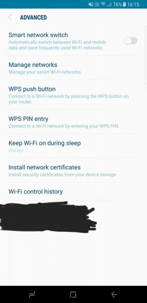

I'm having this very issue, however as you can see, I do not have this option. Mine is an S8+ on EE (U.K), if that has anything to do with it. I've also noticed that when this exclamation bar pops up, it seems to also effect my macbook, but the moment I disconnect my phone from the wifi, the internet on my macbook starts to work again.
I'm fairly sure this isn't a problem with my router as I've never experienced this before on any device.
I'm really unsure of what to do as this is becoming a very bothering issue.

Strange I don't seem to have that setting on my UK phone. WiFi is working well.
