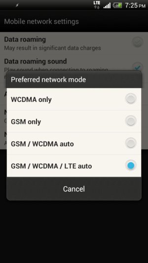

Can you get to this menu on stock?
I can force it to ignore lte from there, but I have always been rooted, so not sure if it is available. Not as easy as a toggle, but not buried.

Those settings are available using #*#*4636*#*#. Unfortunately any changes made do not stick.
