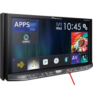

On the Pioneer, you can switch (toggle) back and forth with the mode button (see below). You can have the map up without navigation, your Google Now cards, phone dialer, whatever you want showing in AA, and also switch to normal Pioneer audio functions/AV screens. And the Pioneer audio plays all the while (or your audio of choice).
