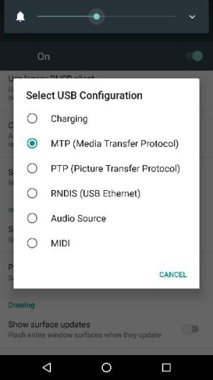

You should see something like this menu after you click on "USB options" in the drop down notification shade when it's correctly plugged in and letting you pick a data mode instead of charging..then it will disconnect from PC and Reconnect as a file device

This is what I was talking about.
Like I said guys and like the video shows, it doesn't show the dialog.
