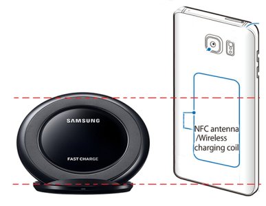

I just got a Fast wireless charger with my note 7 and it charges just fine ( in a Slim Spigen and Supcase Ghost Shell) but when i go to charge my note 5 i guess it may be the case (VRS High ProShield) its in its hard to find the sweet spot..but without the case the charger works fine on the note 5 ....if you have a case that makes the phone taller it kinda takes it away from the sweet spot of the official charger stand...
I run my Note 7 horizontal on the Samsung Wireless Fast charger stand - when vertical, the charging coil doesn't center on the battery as well as it does when you lay the phone sideways. It might just be me but it seems to charge faster with the phone sideways too?
I have the same thing happening to me, mine doesn't charge at all when on the vertical stand with a case, it's weird because the case doesn't add much to the phone. I can charge it horizontally with the case on.
Basically. the upper part of the charging coil on the phone ends up above the charging coil of the charger... not a lot, but enough to make a difference. When horizontal, you can have the entire surfaces of both coils aligned much better... nit-picking, but I still feel it charges quicker! It also lays closer to the counter so I don't knock the damned thing over trying to remove it from charging. :-)
