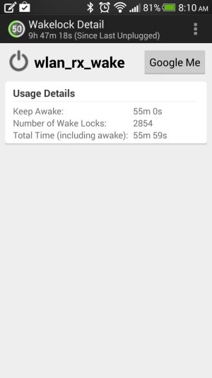

So i have noticed that on standby my phone seems to losing more battery than it should overnight while on wifi. I checked my gsam and came across the attached wake lock issue.
Any suggestions? The little research I've done suggests it's connected to wifi and possibly a router problem. But I'm not quite sure.

I was having the same issue and made a few changes. I set persistent IP reservations on my router for all devices, a little different than static IPs since I don't want to hard code IPs into all my devices, it basically hands out the same IP to my devices each time. The way you do this will depend on your router. On my Netgear it was in Advanced, Setup, LAN Setup, Address Reservation.
Then I changed the phone's settings in WiFi, Advanced, "Keep Wi-Fi on during sleep" to "Only when plugged in." That made the wlan wakelocks go down to almost nothing.

Your router might not support static reservations. I'm not sure it's really a great fix anyway. It was just one of the things I tried.
Yes, setting wifi always on to only when plugged in will revert to mobile data. You can pretty easily limit mobile data usage though with the smart sync feature for mail accounts and only updating apps over wifi. But as adriandb notes just plug it in. These aren't NiCad batteries, modern phones are meant to be charged. Follow the ABCs of charging, Always Be Charging. USB chargers are cheap and abundant.
