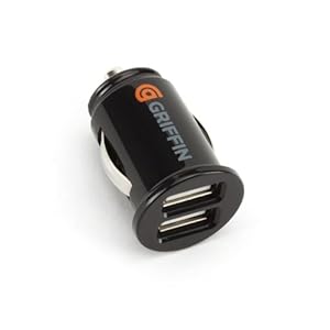

this is what i use, i am able to charge 2 phones at the same time both androids, the gs3 and captivate. i like it cause it is small and when i am not charging the phones i unplug the cables, and the cover for the socket can close with not problem
Walmart.com: Griffin PowerJolt Dual Micro Universal Charger: iPods & MP3 Players
