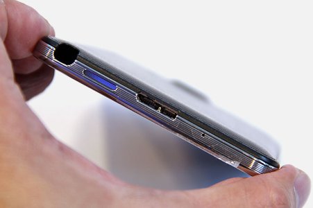

3.0 cable contains 9 wires, instead of 4 like in 2.0 cable, it should be ~30% thicker, the plug also is much wider and have two "forks". It should get at least twice the speed you reported.
