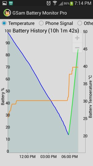

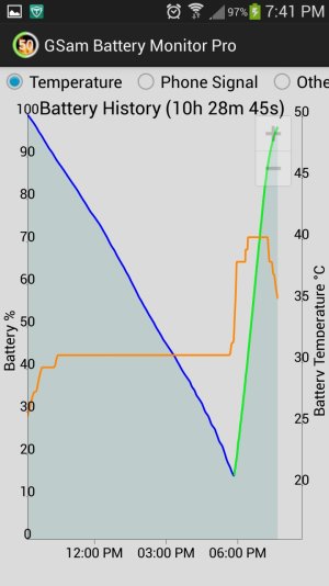

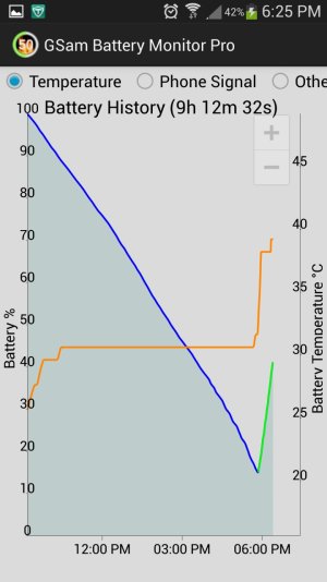

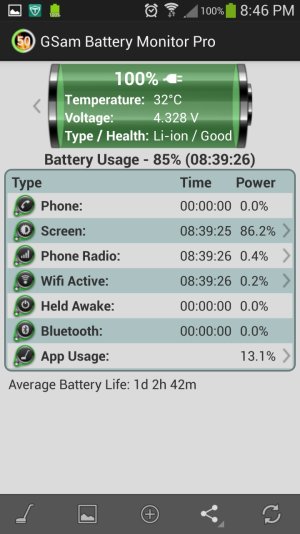

Some battery data for me today. I first drained the battery down to 15%(playing video 9am- 5:50pm) and then charged back to 100%(6-7pm), then kept the phone playing video while plugged in(after 8pm).
As you can see, normally battery temp is in the low 30 C range, charging the phone from 15% to 100% raises it to 40C+. However as phone's battery % pass 90% the charging slows down and battery temp drops back to low 30s. Keep the phone running while plugged in (90-100% battery) doesn't affect battery temp much if at all.
Since over-discharging & heat are the two biggest killer of Lithium ion battery, you are much better off leaving your phone plugged in when you can instead of letting it drain all day then recharge a large %.

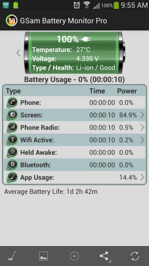

Edit: added One last screenshot(9:55AM): my battery temp after leaving the phone plugged in overnight: As you can see the battery temp stays very cool(Ambient is 24C).

I know the thread is old but I saw those interesting screen shots by NovaWiz, GSam shows a cell voltage of 4.335V while 100% capacity.
I thought 4.2V should be the limit for Li-Ion ... at least my HTC phone's battery cells don't exceed this voltage level.
Does Samsung this for to get more battery life with charging up to 110% capacity level?

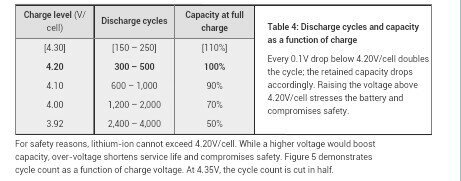

Battery Univerity shows this table with 110%
Link

Did a little search ... there are Li-based batteries with an OVP of 4.35V :)
Maybe Battery University should update ... but even if these batteries are safe, have they the same count of discharge cycles over their life span as batteries with an OVP of 4.2V?
