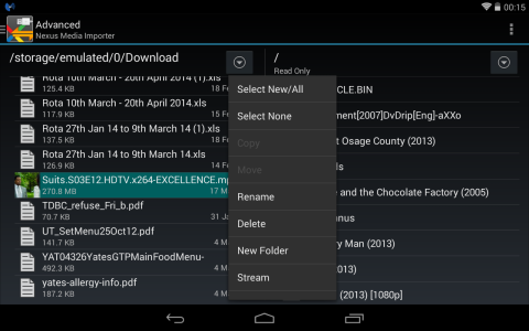

I'm aware this thread is old but I am having the same issue as Deniik - when I click on the file i wish to transfer to my usb stick the copy option is disabled. screenshot attached.. any suggestions?

The right pane (USB drive directory) on your screen shot says "Read Only". Did you remember to tick the "Allow Writing" option on NMI settings? Also, NMI can not write to NTFS formatted drives. See item 1 of MJKearney's post.
Yes Sonny_P the blooming "Allow Writing" that is what I was missing! I'd already checked the format so I knew I was ok on that account. How did I miss the allow writing option. What a ninny! Thank you kindly! :)
