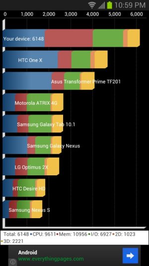

Hmm... Heard a lot of disappointment about this MA6/MB1 Update... Just ran quadrant and got the highest score I ever have. Getting a score over 6k has been a consistent thing on this phone but... Heh?
I'm happy.

Quadrant benchmark tells little to nothing about the speed or smoothness of a ROM or phone.

Your missing the point... Comparetavly... Same phone... Same tests my SPH-L710 is seemingly running faster.
Having mumbled that... Time to go freeze that useless app! :rolleyes:

You can run the benchmark 10x in a row and get scores ranging from 5000-6100.
