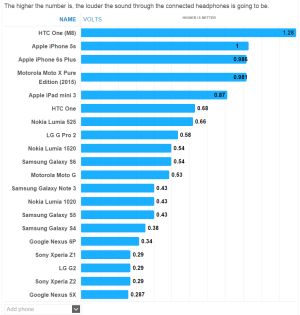

Xperia audio output through the headphone jack is garbage compared to the iPhone 5s and especially the HTC M8. Bitrate has nothing to do with volume levels and Sony's ClearAudio is nothing but an eq curve that colours the sound into making you believe it is clearer when all it does is boost the high frequencies albeit not even tailored to the specific headphones connected! Yes Hi Res audio IS a thing, but there is so many more important factors affecting smartphone audio quality and Hi Res audio in the smartphone market is mostly just a sales pitch that people believe.
What determines output level is RMS voltage.... do some online research! I agree, loudness isn't everything, but some of the best high end headphones need more output voltage and Sony Xperia is useless with these. Most of the HTC phones and iPhones sound better than the Xperia's, with lower crosstalk, more dynamic range and, yes, the volume you need to drive real headphones.
Also check out some phones on gsmarena.com they do all kinds of audio tests on phones
