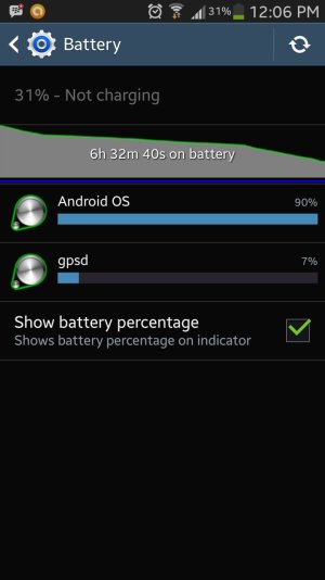

I'm having the same problem, using my phone as much as I did before updating to 4.3, same apps runing and the battery drains twice as fast. Watch this capture. This was taken 6 hours with my phone "sleeping" not even touched the phone in that time with GPS OFF.
Also did a factory reset WITHOUT backing up and the problem persists.
