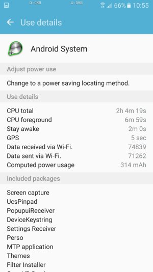

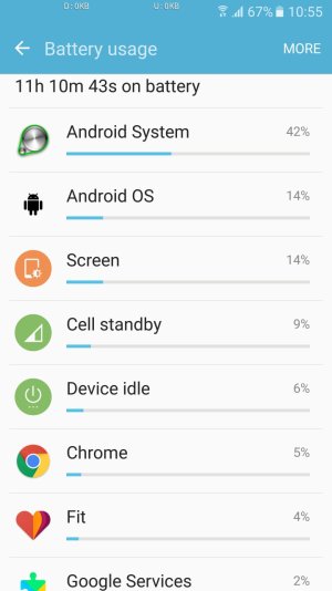

I am experiencing the same problem of a huge battery drain when the S7 is idle for example in overnight when the device is not used. I have uninstalled or disable almost all apps, but I doubt it is the apps' fault, battery manager shows that it is purely the "Android System" that drains the battery.
Here is the latest result. In the last evening I fully charged the phone, restarted it, closed all the apps from recent list, checked that all updates and backups were done before disconnecting the charger and leaving the device untouched during the night.
In the morning I discovered that the battery status was dropped down to 70%. That is a degrease of 30% in ~7 hours without doing anything with the phone. Now around noon there is less than 50% of battery remaining. Crap!
My wife also has a Samsung S7, the exactly same model, bought in the same day from the same shop, we are living in same house, have the same operator, connected to the same Wi-Fi access point. Her devices loses about 3-5% of battery overnight.
When examining the battery usage between our phones it is even more clear that the sole reason is the "Android System". All the other apps and things (e.g. Cell, Idle, Screen, etc.) seem to consume about the same amount of power, except the Android System in my device has many times more CPU time and power usage.
What could be the reason? Is there any way to more accurately determine what are the processes that contribute in the "Android System" battery consumption reading? The battery usage window also lists lines "Data receiver via Wi-Fi" and "Data sent via Wi-Fi". What might be the units for the numbers? Kilobytes maybe? Anyway, this is also much larger number in my device than in my wife's S7, which indicates my device also transmits data while in sleep. Unfortunately this stupid thing doesn't distinguish different processes, but instead sums up everything as a "Android System" process.

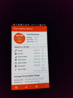

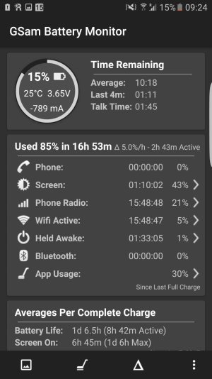

My s7 drains when sitting idle on the table drains about 5% per hour and about 10 % per hour if browsing and 17 % if on youtube.
Factory reset (with no new apps installed - except gsam), still shows 5 % drain per hour when phone is just sitting idle. GSAM doesn't show anything strange except the fact the per hour drain when screen is off is still quite high.
when i first got it (less than a month ago) over night was only about 4-6 percent drainage now it is up to around 30 % per night!
My wifes s4 mini drains around 1 % per hour when phone is just idle sitting on table while s7 edge drains about 5% per hour and easily outlasts my s7 edge it is a disgrace ! for 700$+ phone
Has anyone solved this problem successfully ?
Surely there must be someone who as solved it or got it fixed or returned ?
The orange gsam photo is for s4 mini the others for s7 edge (pls notice the screen on time in both) Screenshot_20170129-092115.jpgScreenshot_20170129-092455.jpg20170129_002639.jpg

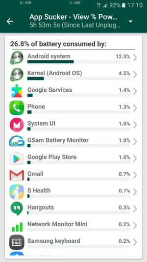

I have tested this a little bit more. As we all already know the "Android System" is a sum of many different things and processes that consume power, which are, for some reason (maybe a technical reason), not listed individually. I don't know exactly which modules are included, but WiFi is definitely one, and it is a big one that may consume lots of power.
If your device in unused, like overnight, then Android System power usage is mostly WiFi standby power drain. Well, maybe if there are some updates or synchronizations, then this may also include some of the CPU power required by those processes. Anyway, if WiFi is on, then all the data transfer is done using WiFi, that will increase the WiFi module power consumption. If one's phone has lots of data usage, then obviously Android System is dominating in the list.
It is, however, a percentual number we are looking at, which must be compared to other processes in the list. If one plays some really CPU+GPU intensive games, they will definitely eat majority of the battery and the percentual value of Android System becomes insignificant.
I have now had my device for 6 hours with WiFi turned off and the Android System doesn't appear in the battery list at all. With WiFi enabled, Android System would read something >30%. That supposedly is the WiFi idle current.
I have a fast AC1200 dual-band ASUS AC56U router. Next I will test if connecting only to the 2.4GHz frequency signal is more energy efficient than the full speed AC-speed.

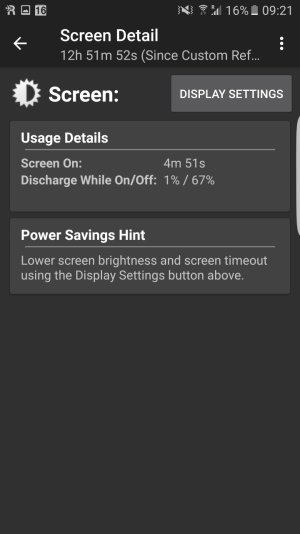

I also tried the GSAM battery monitor app. What is wrong with it? It shows completely different statistics that the built in battery monitor. See the attached screenshots above and below taken at the same time.

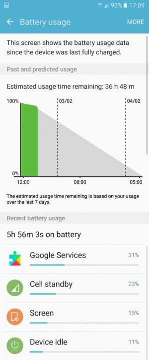

EDIT 3.2.2017
As I mentioned before, I tried connecting to slower WiFi. Here is the overnigh result in battery consumption. It indeed seems that the 2.4GHz WiFi consumes much less power than the fast 5GHz/AC connection. Here can be seen that the Android System again doesn't even show up in the list. I wonder why Google Fit has eaten that much power, the phone has been standing still whole night.
