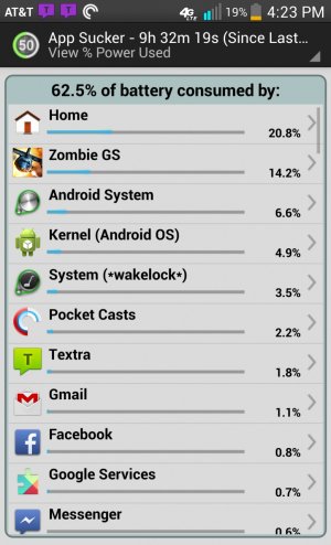

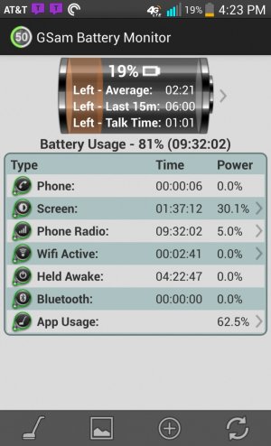

Ok, so there has been a ton of talk about the great battery life on the G2, it's one of the reasons I bought it after all. But, in the week and a half since I received mine, battery has been pretty pedestrian and legitimately bad when compared to all I've heard and read people saying about it. Ultimately, I'm wondering if I have a defective unit and should look into returning it, or if anyone else has seen similar problems and has a fix/idea.
I've posted screen shots of the battery breakdown for today. This is a perfectly typical day both in terms of usage and battery results. Some other info that might help:
I'm on ATT and wasn't stuck in area with bad signal to my knowledge
I keep the screen always at auto-brightness with the baseline level at 50%
I used no GPS or Bluetooth and had both off all day
You maybe be able to see this from the apps usage screenshot, but I have background sync on for google apps, facebook, yahoo weather and that's about it and even those i set to less frequent intervals.
Also, I heard some rumblings that at&t models were suffering some battery drain problems out of the box and the solution was to factory reset them and the problem was fixed. Tried this two days ago to no noticeable effect.
I understand that "mileage may vary" but when I see reviewers like Jerry, the guys from The Verge and pretty much everyone else claim that even driven hard, you can get a day out of this things, and I'm lucky to make 11 hours with 1.5 hours screen on, I have to think something else is amiss. Any thoughts? Should I go back to at&t and try to get it replaced? Thanks all. 2013-09-25-16-23-27.jpg2013-09-25-16-23-44.jpg

Your phone was held awake for 4.5 of those 9.5 hours. Were you playing music for most of those 4 hours? If not, you've got a wakelock problem.
Out of curiosity, do you have Google backup enabled? If you do, disable it (Settings > General > Backup & reset > uncheck "Backup my data". Then reboot, charge it back to full and monitor again.
Edit - Also, what is "Home" at the top of your App usage list? I haven't used GSAM in ages and don't recall what that represents.

Yeah I noticed the wakelock thing too. I was listening to a podcast for maybe 1:30 or so on pocketcasts. Anecdotally, i've noticed drainage issues (4-5% an hour of relative non-use) when I wasn't as well though...and that doesn't account for the entire time.
"Home" I believe refers to the launcher.

as i see in the pics 9:30 of music streaming will def hurt battery. also i see a game up there used 14 % if its a high quality 3d game yes u will get drainage.

Sorry if i'm missing something, but where in the picture does it show 9 hours of music streaming? The only streaming service i was using was Pocketcasts which only took 2.2% and was streaming for less than 2 hours.
The problem is what's happening when I'm doing neither. Anecdotally, the streaming podcasts, with the same app, is having a harsher effect on this phone than my s3 and s4 before them, which really shouldn't be the case. Also, while I forgot to get a screen shot, last night I lost like 12% over 2 hours with the phone in my pocket, no streaming, a few texts and nothing else. Again, for a phone all the reviewers are saying "even pushed hard, will make it all day" that's just not good.

I would certainly agree losing 12% in your pocket over 2 hours is not right. Were you in a poor signal area? Even then it's hard to believe you'd get that kind of drop in that amount of time. I could see an S3 doing that, but not the G2.

Yeah, I just listened to Jerry and Andrew's podcast on the G2, and both saying they can get 24ish hours with 5-6 hours of screen on time...as my OP attests, I'm failing to get half and half of that.

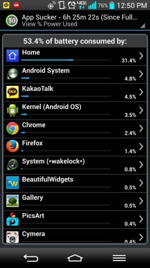

I noticed your home taking 20% power.. I am having the same issue too. After i charge my phone to 100%, the % for HOME stays relatively high. However the HOME % goes back down after i restart my phone after full charge

You need to figure out for sure what"home" is. If that's your launcher, something is haywire. I've never seen a launcher consume that high of a percentage of battery.
