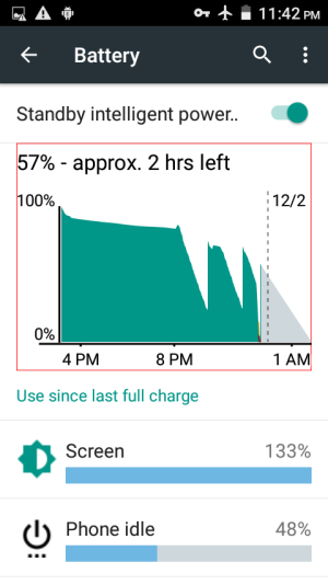

I've attached a screenshot from the Settings/Battery screen of my android phone that shows the battery level can be wildly inaccurate. In the image, each of the three huge jumps in the battery level corresponds to having powered the phone off then on. (The phone was not connected to a charger during any of the period of time shown in the screenshot, but even if a charger had been connected, that wouldn't explain a jump of 50% or more in about a minute.) Also, note the 133% usage reported for the Screen... I don't understand how a service could really use more than 100% of the power. (I've also seen it report usage greater than 100% for Phone Idle.)
Once after the level had appeared to reach 1%; I powered my phone off and on (which caused the percentage to jump) and then played videos for two hours. That proved the battery still had a lot of charge remaining even though the battery level had fallen to 1%.
People often ask for help in forums because it appears their phone's battery drains fast. Then other people always respond that the battery must be replaced or that some power-hungry app(s) must be rapidly draining the battery. I'm posting this message because there's a third possible explanation: The battery might actually have a lot of charge remaining, and only appear to be draining fast because the battery level percentage is very inaccurate.
You can quickly test whether your device has the problem: When the battery level appears low, power the phone off and then on, and see whether the battery level jumped. (It needs to be a power off then on. Simply rebooting the phone won't make the level jump.)
My phone is a ZTE Obsidian. I tried replacing the battery with the battery from my brother's Obsidian, which has almost never been used and is almost always powered off. Using his battery, the battery level still behaved similarly: wildly inaccurate, appearing to drain fast but jumping after a power off/on.
I've tried the battery level calibration procedure (charging to 100%, then discharging until the phone shuts itself off, then charging again to 100%) but that didn't make the battery level behave any better. If anyone knows how to make the battery level behave reasonably, please post the procedure!
Because the battery level is so inaccurate, I've learned to pay more attention to the battery voltage than the battery level. Many third party apps can display the voltage; two examples are Battery Log and Elixir 2. In order to increase the battery's years of service, I avoid deep discharges and avoid full charges. You may have encountered advice to keep the battery within a range of about 20% to 80% to increase its years of service, but the inaccurate battery level interferes with that strategy. So I try to keep the voltage between 3.5V and 4V... I plug in the charger when the voltage drops below 3.5V and disconnect the charger when the voltage climbs to 4V. The voltage can behave oddly too (due to changes in load, or connecting/disconnecting the charger, or needing some recovery time for ions to diffuse back after a heavy load) but not crazy behavior like battery level does. To make it semi-automatic, I installed E-Robot (an automation app similar to Tasker) and created a custom E-Robot script that periodically checks the voltage and makes a sound when the voltage is outside the desired range, which prompts me to connect or disconnect the charger.
