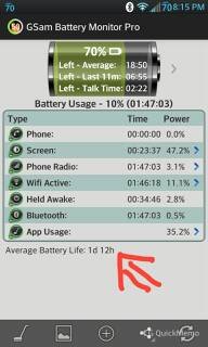

The biggest thing to look for is whether an app is holding your phone from going to sleep. These are known as wake locks.
Grab an app that can show you what is holding your phone awake.
I recommend Gsam battery monitor, but that's because I'm the author :) Better battery stats does a great job as well. A simple Apollo like cpu spy will also show you how long your phone spends in deep sleep. You want this to be as high as possible.
On my Sprint lgog, I get 36 hours average on a charge. Not too shabby...
Sent from my LG-LS970 using Android Central Forums
