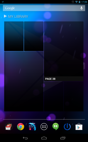

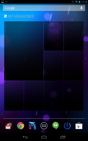

Every since the latest update the content of "My Library" and/or "My Magazines" will, at random, display blank/black tiles instead of thumbnails of the actual items. If I click on the blank tile it will open the book/magazine but from an aesthetics point of view it doesn't look great.

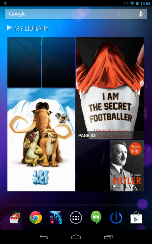

It's probably worth mentioning that the blank tiles seem to move/change at random. For example the Ice Age thumbnail will turn blank at random or for 10 minutes all the thumbnails will work fine before some turn blank again seemingly at random.
Any ideas?

Less than 10 minutes since my post above and all the tiles have turned blank. Note "Page 38" still displays and all the tiles are the same size and in the same location but the thumbnails/images have disappeared.
Based on past experience I'm confident some of the thumbnails will return but it's a lottery as to which ones and for how long.
