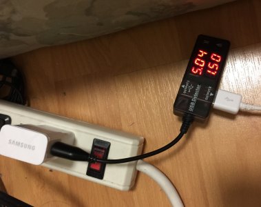

This problem is not difficult if using this tool
usb current voltage meter | eBay
Current should be at least 1.5 Amperes, voltage should be at least 5 Volts, you should use a known working USB cable and charger to test to see if problem coming from charger or USB cable. If everything is fine, next step is test a new flex USB charging cable. Since you didn't mention the model, I cannot tell which one you should buy; Tab 3 has different screen sizes and models, just say Tab 3, nobody would know which one is your tablet.
Just tell me exactly the model and do some basic steps of troubleshoot first, then I can tell next steps which is more advance knowledge and skill to look at battery connector.
There are many unknowns, no one can be specific tell what is the problem after you do some basic testings. I know someone is very silly send the tablet a round trips to a repair center to fix a problem from a bad charger or USB cable.
