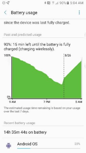

So I'm at a complete loss at what is going on. I have the official fast wireless charger and it is taking all night to charge the Note 7.
I had the wireless stand at first and exchanged it for the flat one thinking it was the defective but nope.
As you can see from the pic, I put the phone on the charger before midnight I think it was around 11:30. It indicated it was fast charging and it would be fully charged in under 2 hours, the phone was around 30%.
I wake around 5am and notice the fan on the charger is still running and the phone is only at 90%.
Do I have a bad phone? I don't think software has anything to do with it, would it? Anyone else experiencing this?

I only experienced that once and for me, it was due to enabling the screen saver when charging... soon as I noticed what was going on, I disabled the screen saver and now it's fast charging like normal....

I do have that enabled. Going to disable it and see what happens.

Go to settings >battery>top right advanved settings>fast wireless charging tab should be blue. I had the same issue initially
