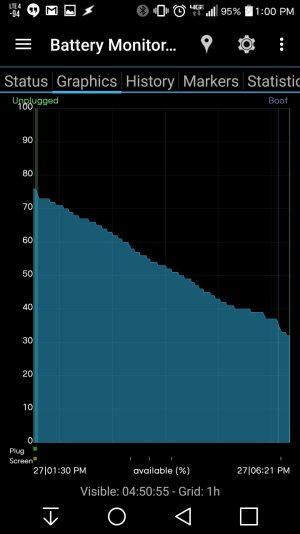

I was in a very weak signal area on Saturday and even with the screen off most of the time, the battery still drained pretty badly. Once I left this area, the battery life returned to normal.

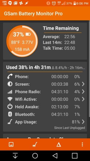

Have a Question - Which app (or apps) is using 81% of battery? Cell radio, wifi, blue tooth & screen do not show excessive battery drain.

Yup -- that's a very good question. Could it be an app that is going crazy trying to find location or something like that?

Not sure. I was in a hurry so didn't get a chance to investigate. The held awake time is very high too.
