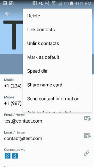

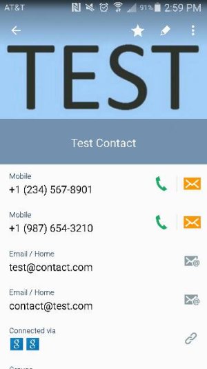

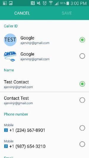

Yes, but it can be changed and for some reason it is working for some and not for others. I did get it to work with this fake contact I created, but it's not working on the Contacts I already have. I added a few screenshots.

This problem has bothered me a lot; like others said, the 'Mark as Default' feature works in older Android versions/currently with new contacts, but not with old contacts in Lollipop.
However I believe I have found a (cumbersome) work-around.
Go to a contact you want to change the default picture for. If that contact has an email listed, add a new email (a nonsense letter like 'a' works). Save the contact; the application should now notify you the contact has more than one email address and asks you to pick a default. It then takes you to a screen where you can select any default option: contact picture, phone number, etc.
If your contact has no email I imagine adding two new ones would work just as fine.
This worked for me on my Samsung Galaxy S5. It's not the nicest fix but a fix nonetheless. Hopefully it works for all of you
