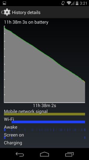

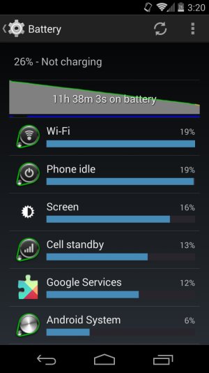

I noticed from the past few days that my N5 seems to have abnormal battery usage pattern. There are days with mostly light use (text messaging, whatsapp messaging, some web browsing, minimal on screen time) I can go for 2 days without charging, and I am only losing 1% battery per hour when it's in stand by. However, they are times (see attachment) when I didn't use my phone for 11 hours, but the battery level is down from fully charged to 26%. Can anyone give me some ideas on what may be the culprit?
I have the same issue with unexpected battery drain. I'll have to post my screen shot. With no apparent reason, the phone battery would suddenly nosedive. This has happened 2 times at night. WTF? At its best, my phone loses 1%/hr
From your screenshot, it looks like you have WiFi wake lock. Go to WiFi settings - advanced, and make sure the checkbox next to 'WiFi optimization' is checked.
If this doesn't work, try a factory reset and see if the issue persists.
Try tapping on Cell Standby, and see if it says how much time you don't have signal. Since you mentioned that your cell reception isn't very good, that certainly could be a big contributor to your drain, because the radio has to work harder to find a signal. Also try GSam Battery Monitor, which can give you somewhat better breakdowns of battery use.
Sent from my Nexus 5 using Tapatalk
Thanks, I just looked into my wifi settings, and wifi optimization is already checked
I just checked, and it shows time without a signal is 12%. Someone has suggested apps such as wake lock detector and better battery stats, I looked them up at Google play and they do not support non-rooted phone running kitkat. Seems that GSam Battery Monitor will work, I'm gonna give it a try
