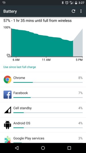

It takes ~7 hours to go from zero to full charge with wireless charging.
Wingznut
Feb 10, 2011
187
Visit site
I let my Nexus 6 go down below 10% yesterday before I put it on my LG-700 Qi Charger... 6.5 hours later it was at 99%.
Just in case anyone was curious how long it takes to charge wirelessly. :cool:
I notice that here LG WCP-700 | LG USA it says "High Charging Efficiency will fully charge a standard battery in under 3.5 hrs" - the question is, what do they consider to be a standard battery? At 3,220 mA, the Nexus 6 battery is quite large.
I would also verify that the Nexus 6 is positioned as accurately as possible on the charger as best charge rate will occur when the two coils are exactly aligned. See steps 6 and 7 here to get a good idea of the location of the N6's charging coil.
WOW.. I have the TYLT Vu and I went from 4% to 99% in just over 3 hours..... It chargers about 28% per hour on the Vu...... At work last week I twice timed how much additional charging went in after exactly 1 hours and I got 29% and 27% on both days in a timed 1 hour.....
I've not even taken the turbo charger out the OEM packaging... I have 3 Vu chargers.. One in my kitchen, one on my nightstand and one on my desk at work... I've been charging wireless exclusively for 2 years now...

I am really starting to doubt the value of wireless charging. Way too long to wait for a phone to charge, no matter the size of the battery.
I don't know about value... It's much slower than plugging it up via a USB cable plugged directly into a wall socket.... and without a doubt way slower than the Turbo charger included... but if you work in an office at a desk 8 hours a day it's a much easier way to charge (In my opinion) than fumbling with a cable that could fall behind your desk/night stand or get hung on something when you go to pick it up... I have charged via a wireless charger exclusively with my Nexus 5 and Nexus 7 (and now my Nexus 6) I've never had it take more than 3 1/2 hours before.... I've now had my Nexus 6 two full weeks and from 5% to fully charged is roughly a 3 hour 20 minutes process on average.... but during the day at work I set it down for an hour here and there and it just keeps the battery fully charged before I leave for the day... At home I have one in my kitchen for when I walk back in from being out and about.. I set it down for an hour here and there as I go in and out of the house over the weekends.... and then on the one on my nightstand at night while I sleep...
With my Nexus 5 if I knew I needed a good boost before going somewhere I'd plug it up via the cable and go into airplane mode to charge faster..... With the turbo charger I wouldn't need to go airplane mode... but my Nexus 6 easily last 12 - 15 hours on a single charge and when I "Top Charge" an hour here or there my battery can easily last 24+ hours.....

Visit site
Probably the charging plate. I was seeing between 700-800mah charging on my nokia plate. There are plates that can charge quicker. At 7ish hours, you are looking at around 450mah which is pretty slow even for inductive charging

Resonance wireless charging is supposedly the future and charges much faster.
A ton of potential with Resonance wireless charging.. Needs a lot more backing and adoption... Google back Qi and it's become pretty mainstream with most Android OEM's right now.... According to most calculations the turbo charger takes you from 0 to 100% in 1 hour 58 minutes... I've gone from 5% to 99% in 3 hours 20 minutes with the TYLT Vu wireless charger and a case on the phone.... considering the difference between a "Turbo" charger and a wireless charger an extra 1 hour 20 minutes (Give or take a minute or two) is pretty good... I'd have to guess either Wingnut had a bad wireless charger, it wasn't line up very well (Which can be a problem with Qi) or exaggerated the 7 hour charging time..... Going on two weeks with my Nexus 6 and in an hour I get 28% on average back in the device.... It's never been plugged up once and I only charge via Qi Wireless charging.... It's not super fast but it's not even remotely close to 7 hours slow....
