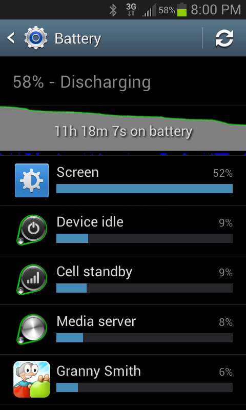

My battery life has been excellent. Here is today...
That's with 1 hour and 15 mins of screen on time. Did you flash the full wipe version or the no data wipe?
Battery issues are hard to diagnose as there are so many variables, but so far mine has been stellar on this ROM.
