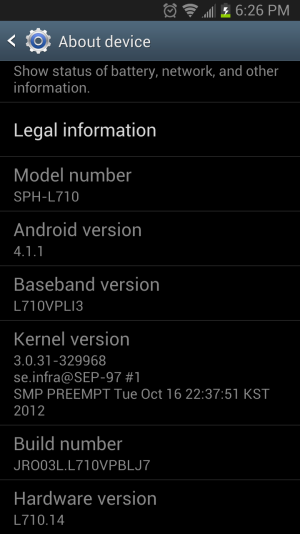

I flashed CWM, but I still get a failure when attempting to install the update. I have tried three different sources. Now, I am trying it once again with CWM and using [ROM] 11/4/12 Sprint Touchwiz Jelly Bean 4.1.1 (L710VPBLJ7) Odex/DeOdex - xda-developers as all other attempts have failed.
GK3K
Jun 18, 2012
229
21
Visit site
You read my mind.
So, to clarify, I tried installing the OTA room using stock recovery and CWM and they would both fail with that damned Swype message.
I downloaded the linked rom and installed it in less than 2 minutes via CWM. Phone booted up and has the new boot animation. It is currently in the process upgrading my apps.
