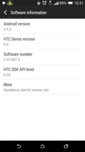

KyaKING
Sep 2, 2014
2
Visit site
I started having the same problem with my headphones, my Urbanears Zinken headphones won't be recognized while my HTC earplugs which came with my device works fine, my headphones works fine with everything else (computer and other mobile devices.) I bought the headphones 2 weeks ago, and I was really enjoying the music (with BoomSound turned off, seems the clarity decreases with BoomSound on to me.)
so I would like to know how to fix this..
please help. =(

KyaKING
Sep 2, 2014
2
Visit site
I uploaded my software info, as you can see, I have downloaded the SoundAbout app, works great but it takes too much effort to switch from listening to music to watching a video on youtube with speakers for me. Also, my headphone functions don't work (press button to answer phone call, pause, play.) and I can't turn BoomSound off, which bugs me the most..
hope this gets fixed soon.
also, do you guys know any great games? I like games like Osmos HD, Duet, Cytus, Deemo.
Thanks.
Kya.

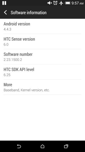

NiteKnight
Sep 2, 2014
2
Visit site
I am still having this issue; occasionally when I plug in the headphones the headphone icon shows up, but very quickly disappears again though I have been unable to predictably get this to happen. I have sent an email to HTC customer support and will let you know what they have to say about it once I hear back from them.
You can see my system info attached.
