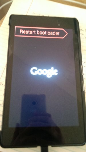

Hi all,
When I press the power button, it get stuck on the Google logo screen and won't move past it. I've tried going into the bootloader screen, but when I press Recovery mode, it just boots back up to the Google logo screen.
I tried to flash the stock image from Google's site, but I'm having trouble unlocking the bootloader. I'm on a Mac and have the adb/fastboot files in my current directory. I ran "./fastboot oem unlock" and on my Nexus, I accepted the changes. Afterwards the LOCK STATE says "unlocked". However, when I restart the bootloader (choosing "Restart bootloader" using the volume keys) it reverts back to "locked".

One thing that has been bothering me is that you said you chose Restart Bootloader. After the Lock State says unlocked try to use your volume keys to select 'Start' and click the power button to factory reset and reboot. If the problem persists, do tell so I can suggest a user made bootloader unlocking tool.

Thanks for the reply. I tried clicking 'Start' as suggested, and all I see is the Google logo again. Also, I believe I wiped everything from the Nexus because if I press the volume buttons while on the stuck screen, I see the 'Start' -> 'Power off' -> 'Recovery mode' -> 'Restart bootloader' options like I do when I'm in the bootloader.2014-02-13 07.17.40.jpg

I will suggest that you try the AIO Nexus 7 Flo tool from XDA developers. I would have supplied you with a link, but it is against the forum rules.

I had the same issue and phoned Asus support. They gave me an RMA number and I sent it in to them for repair. Turned out to be the processor board was dead. Sent it in on a Monday ,they fixed it Tuesday and I received it via courier on Thursday. Of course since the memory is on the same board it means your data is gone too. Since it was warranty it only cost me the shipping to send it them.

Hey, so do you have a magentic closure case, and is it still on when you try this?
I didn't have any issues until I bought a new case (love the case), and then the boot loader issue as described here, Google words only no matter what.
I remove the case, and it powered on without issue.

Mine died just like it had lost the battery, no amount of charging would restore life. Replaced the battery and it now boots to Google a sits there. Did the power/volume routine and get a series of messages referencing E: can't mount and the very last message is again referencing E: where it can't mount due to an I/O error. Could this be an error with USB port and can't talk to an external device to restore some data? ASUS said it was the mother-board and $200 would fix it Not going to spend that kind of money on this device!!

Who replaced the battery? It's possible that during the replacement, something else was damaged on the motherboard. Maybe the the person didn't ground himself and zapped a chip or a circuit with static electricity. It sounds like the device is fried. You can get a refurbished 2013 Nexus 7 for under $200 now, so it's definitely not worth shelling out $200 to try to fix this one.

You might be able to have a JTAG service revive it; depends on the exact error messages. I'd agree with B. Diddy that it's probably toast.
