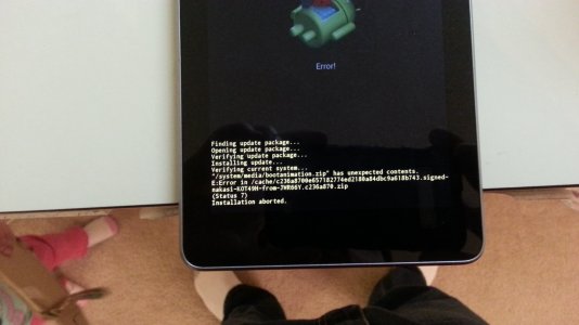

Sorry it took so long for me to reply, the holidays were crazy. So I tried to install 4.4.2 again on the Nexus, but about halfway through the install process, the error message appeared again. This time, I pressed volume up and power as per your suggestion, and it came up with a message. I took a picture of it so I could get some help with it. Any ideas?2014-01-04 16.48.00.jpg

That happened to me I'm rooted BTW and what I did to fix it was connect to PC and download the KitKat update from Google images website then when on the screen with the error message press and hold power and vol up until it says adb sideload then just type in the name of the update which you downloaded eg , adb sideload kit kat Google update.zip

And if done correctly your PC will start to push the update to your nexus - remember to click on USB debugging and set your USB to camera not mtp p.s sorry if my little guide is rough round the edges but I'm not at my PC , good luck....

Oh one last thing - rename that update in your PIC to KitKat instead of those letters and numbers followed by signed by.. So its just adb sideload KitKat.zip
