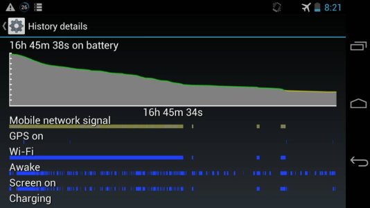

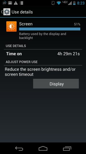

This is what I got in my very first day with the phone...
I know it'll importune even more once I figure out what keeps waking my phone... Had airplane mode on during sleep
Sent from my DROID RAZR HD using Tapatalk
