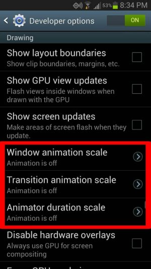

Oh thats an easy fix. Go to settings-> developer options-> turn it on if its off-> then turn off window, transition and animator scale and depending on what it was set on before, youll notice a difference in opening apps. You cant get any faster than this without rooting the phone

I doubt that thisuploadfromtaptalk1375860177821.jpgwill fix the problem that he's describing, particularly since his phone was working faster and now isn't, but you never know - maybe he made those changes before and an OS update reset them.

I doubt that thisView attachment 75948will fix the problem that he's describing, particularly since his phone was working faster and now isn't, but you never know - maybe he made those changes before and an OS update reset them.
Sent from my rooted, debloated, deodexed Sinclair ZX-80 running CM -0.001 using Tapatalk 2
Well since he said he said sometime his phone goes fast but sometimes it goes slow it can just be his mind playing tricks on him so I dont think its that serious of a problem for him to go ahead void his warranty and root the phone and install a rom in order to make his phone faster. The option I stated is the best you can do without rooting

You could go to Settings -> More (if using the Tab view) -> Developer options (you must have this option enabled) -> and set the three following items to Off:
- Window animation scale
- Transition animation scale
- Animator duration scale
