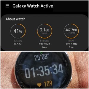

Using the built-in Running Endurance activity, I am only getting 2hrs of use from a 100% charge.
I do have Bluetooth turned on, and music playing from locally stores music.
The Gear app on my phone shows that more than 75% of the battery usage is from S Health.
Brightmes is down to 3
Screen timeout is 10 sec
Etc.
Is this to be expected? How can someone expect to go for a proper run without the watch shutting down halfway?
I am totally new to Samsung activity products; am I missing some other setting? Do I need to avoid Bluetooth on the watch and bring my phone along for Bluetooth music, etc?
Disconnecting my Bluetooth greatly improves battery life, but negates the training and endurance feature of the watch.
