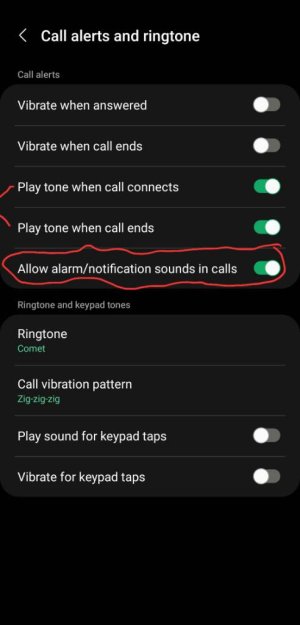

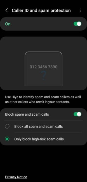

Try also these settings in phone app toggle off , don't think.it work but try , if has option for noise cancelation turn it off also and any spam/caller ID turn of just incase Screenshot_20220119-213231_Call%20settings.jpgScreenshot_20220119-212831_Call%20settings.jpg

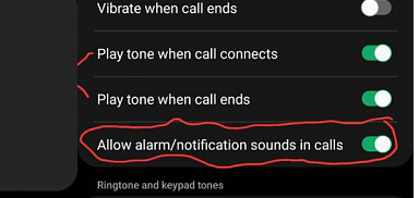

@ mustang7757 I checked and that option is turned on (i.e. to allow alarms/notifications), so once I'm doing testing the remaining apps with permissions to the PHONE app, I will try this. I would rather alarms that I use for specific purposes be able to go off while in a call (e.g. meeting reminders), but we'll see if this works. I'd be willing to use it to get rid of the accursed beeps even if I have to give up other alarms. I must admit, I wonder why Verizon has never mentioned this setting?
Ok let us know, sometimes they can miss a step or didn't know.

So, now I have turned of 'Allow alarms/notification sounds in calls" per mustang7757. Fingers crossed.... or one more step to the insane asylum.

Turning off "Allow alarms/notification sounds in calls" did not fix the beeping...arggh! And I don't use any extra called ID/Spam blocking (just whatever is automatically done by Verizon itself). Any other ideas?
