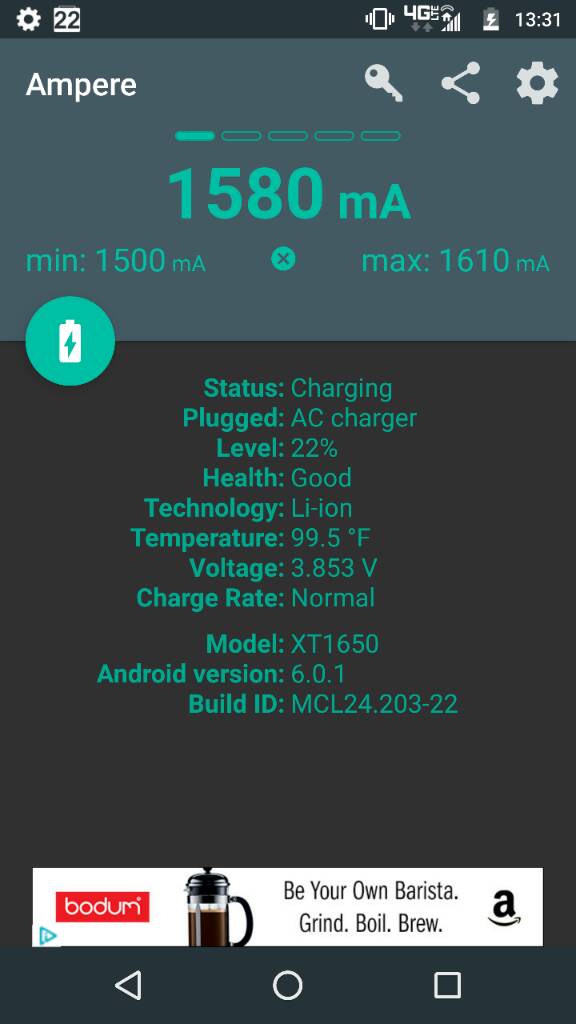

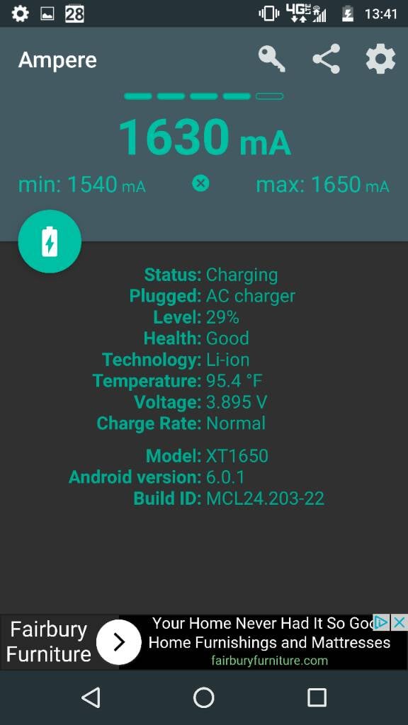

Waiting for a screen shot
This is what I get from Aukey 2.0 charger.
And this is what I get from original turbo charger.
Both were using a Belkin cable rated at 3.1 USB. Ry I know it's not turbo charging so if you want to move this to a different thread feel free.

Re: Proven TURBOcharging chargers & cables
This is what I get from Aukey 2.0 charger. //uploads.tapatalk-cdn.com/20160806/c9c87a70248bbb9336faba67b0fb47dc.jpg
And this is what I get from original turbo charger. //uploads.tapatalk-cdn.com/20160806/441cb56f325a515f229df93bcdcfc6e5.jpg
What do you mean by "original turbo charger"? Original to the Droid Turbo?

It's a similar charge rate as I'm seeing from any of my QC2/3 chargers, which is far under the included charger's rate. I'm hoping this thread will become a reference for finding chargers that work in the 5000+ mAh range.

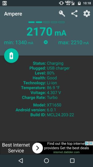

Here's the numbers I get with the Verizon branded usb c fast charger. It did pop up saying turbo charging. It's not as fast as the supplied charger but it'll do. It charges good enough to switch over and start charging the battery mod. 1471103509574.jpg
Ry
Moderator Captain
Trusted Member
Nov 16, 2010
17,654
214
Visit site
Here's the numbers I get with the Verizon branded usb c fast charger. It did pop up saying turbo charging. It's not as fast as the supplied charger but it'll do. It charges good enough to switch over and start charging the battery mod. View attachment 234977
Thanks!
