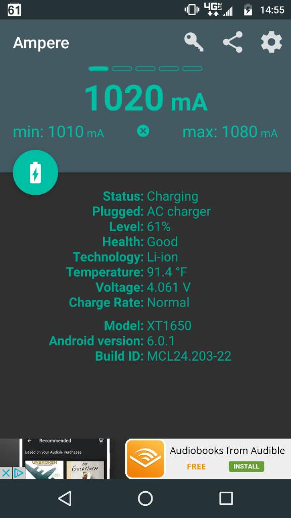

Had to fill a honey do shopping list so decided to try it out. It dropped to 1000 when I connected my Force and Turbo plugged in but still said turbo on the Force. It only showed about 750 using USB A to USB C cable.
Decided to test it and see.
