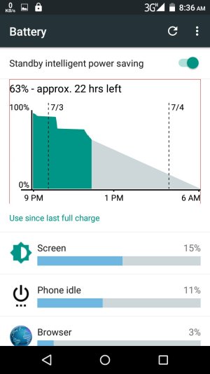

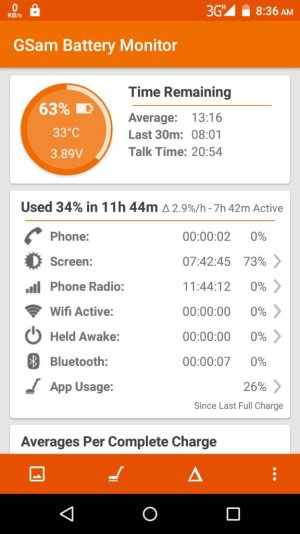

First of all, I am sorry to post it here as my device runs Android 5.1. I am desperate for a solution.
My battery is really performing weird since a month.
Battery percentage drops suddenly when I turn on my phone after sleep.
Suppose, I turn off my phone at 80% and I turn it back on after an hour, the battery will suddenly drop to 76% and it will remain at that percentage for 30-40 mins.
This problem occurs even during airplane mode or when the phone is switched off.
I have tried
• discharging to 0% and charging to 100%
• factory reset from settings 4 times
• battery calibration app
But nothing seems to work
And the best thing is that my battery usage is more or less still the same as it was a year ago. I am getting 10 hour Screen On Time on average.
There's no problem with my network strength...and I don't even think that "Phone Idle" is using battery, even though it looks like it, and GSam proves that. It is just that the battery % reading can create trouble as there may be an incident where the first 50% may last longer and the remaining 50% doesn't.
Here's my battery stats, from stock and gsam.View attachment 286251Screenshot_2018-07-03-08-36-52.jpg

Inconsistent Battery Percentage Reading
My battery is really performing weird since a month. Battery percentage drops suddenly when I turn on my phone after sleep.
I have tried
It is just that the battery % reading can create trouble as there may be an incident where the first 80% may last longer and the remaining 20% doesn't.
Here's my battery stats, from Stock and GSam.
