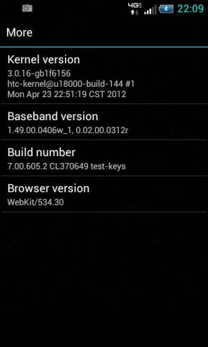

I have the radios posted above by ssethv, 605.19CDMA/605.2LTE is what it is I think. I am more than likely wrong but here is what I think it is 2.00.00.0308r, 0.02.00.0312r is that the numbers I should have? Let me look again. Yeah I am so used to not flashing radios I am not sure if those are what I should have there. Please forgive my laziness.
you should have BASEBAND version : 1.49.00.0406w_1, 0.002.00.0312r. <- this is what it will say if you flashed the radio combo of .19 CDMA / 605.2 LTE. It looks like you flashed the new radio leak. the last part ( 0.002.00.0312r) is the LTE part and the first part is the CDMA part. I know this is somewhat confusing.
FLASH the top combo 2.11.605.19 CDMA/7.00.605.2 LTE
Here's what I have... (attached)
This should be the right one.

HMM don't know how I screwed that up, when I get home later I shall do as you two instructed. I should probably register over there as well you are correct ssethv
