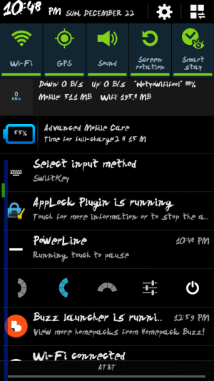

So I was able to update to 4.3 today (Oklahoma City) and my biggest "aaahhhh yeeeaaahhhh" with the update is the display: my phone just seems so much sharper and the colors just look freak'n fantastic, I love it!
I haven't, so far, noticed any problems but am a bit confused on one thing and I wonder if that's just how it is or/and if there's an explanation:
In my pull down menu the "ongoing/running" apps (right above my notifications, pic attached) I have so much more listed then ever before. At the moment I have 7 listed, is this normal? I really don't like it and I have been to each app to see if there was some sort of toggle that I could change but there isn't. Is there a way to fix this or is this just how it is? Otherwise I've only notice a bit more lag in the overall speed of my phone but I like 4.3.
Any thoughts though? Thanks guys!

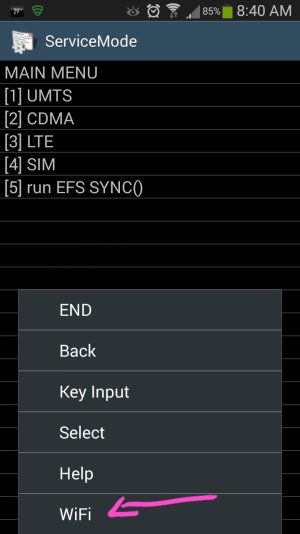

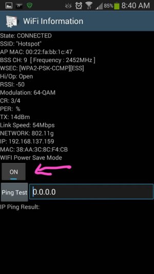

There is also a wifi power saving mode buried in other settings. Bring up the menu using one of the #* codes. I used *#197328640# on the dialer screen. This wifi option is in all of these buried menus, just hit the menu button.
When the service menu comes up, tap the menu button and choose "wifi".
Then you will see wifi power saving mode on, tap that button to turn it off, tap the menu button again, choose "end".
