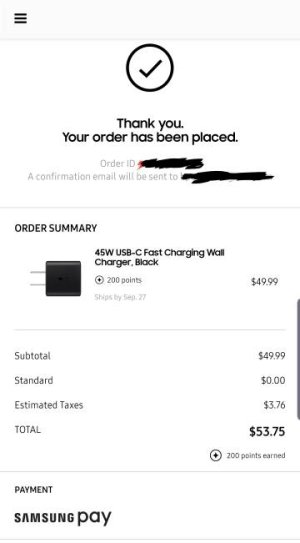

Heads up everyone, the shop Samsung app has the 45w charger available! Act fast!!....
